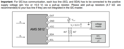

The silver dot on the AMS 5812 marks the location of Pin 1. The AMS 5812 pinout is:
  • Pin 2: Ground
  • Pin 4: SDA
  • Pin 5: SCL
  • Pin 7: VCC, this should be a 4.75V to 5.25V power source.
4.7 kOhm resistors should be used as pullups on SDA and SCL, these resistors should pullup with a 5V source.

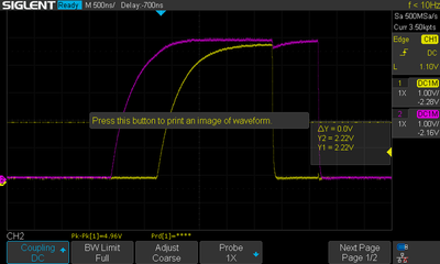

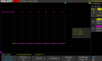

SCL / SDA on Scope. Below Observations.
With AMS5812 Sensor, Peak is curved.
Yellow is SDA and Violet is SCL
Without AMS5812 Sensor. I2C Scanner works fine.
