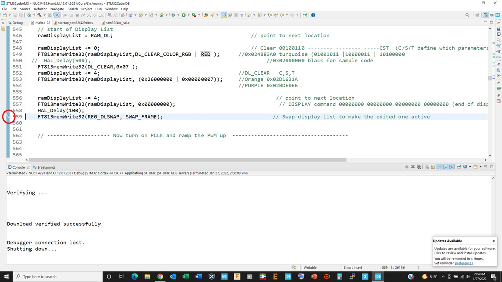

Try a lower optimization level for the compiler, like -O0.
At higher level, the compiler might move code around, reorder, inline,...
The underlying gdb can also break at function entry by using
break <functionname>
in the debugger console. Function might need an underscore prefix _, check .map file.
hth
KnarfB
2022-01-27 3:57 AM
I dont know if you did it on purpose but it seems you disabled all breakpoints.
try unselecting that option in your toolbar

Problem resolved.
