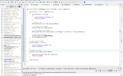

I put it now at the end to not get a problem again. But i found out, that after erasing pages, my writing does not work anymore. If i comment out the erase, i can write the flash. How can the erase prevent me from writin?

You are spot on. I did not think about how big a page actually is ;-).
>>How can the erase prevent me from writing?
It didn't complete yet?
There's some pending error?
Hard to tell anything from screen shot code fragment. Need to see output and sequences from an instrumented process. Best not to single-step in debugger, or dwell on the peripheral view. Print out info about the stages, and the register in hex at each point. Decimal not helpful.
I dont do single step as i know of the problems.
But i found my problem: i did not clear PER and PNB after erase, which gave me troubles. After findind out you can write some flash without erase, i went like this. But it seems that it does not work any kind of predictable.
