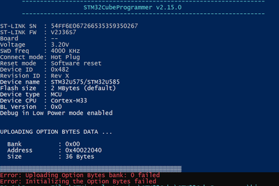

Hello I replicated the steps as given in the app note . I am using the latest version of the programmer ie . 2.15
Tried logging through the CLI
Does not let me read/write option bytes. What am i missing ?
