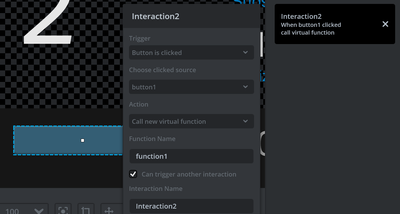

2023-11-13 10:18 AM
Change your handler to
to virtual function call and in func buzz start no delay... stop place on timed handler or next screen onload part.
Delays in code result to block gui ...
Too you can use next interaction to start screen change when this ends...
