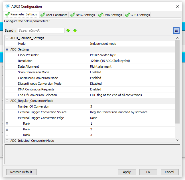

I am configuring both ADC1 and ADC3 to run using DMA, but I'm getting different behavior between them.
This is the configuration for ADC3, ADC1 is configuration the same:

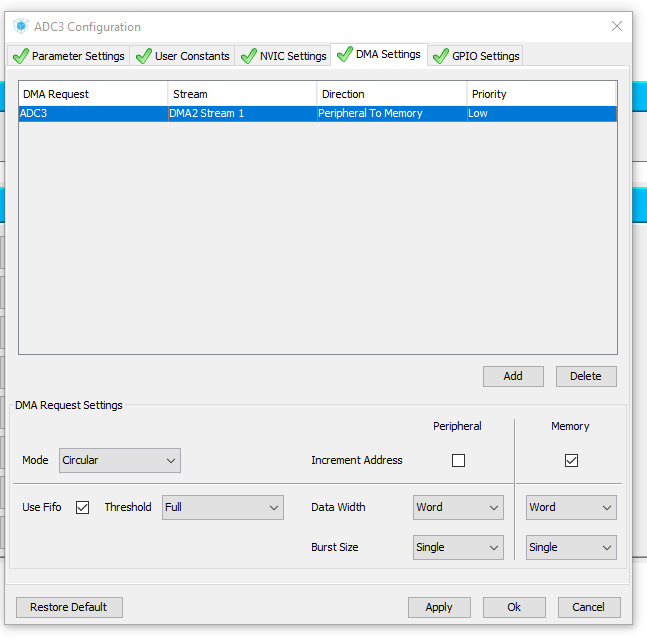

ADC1 is configured to use DMA2 Stream 0, and ADC3 is configured to use DMA2 Stream 1.
This is configuration of DMA for ADC3. The configuration is the same for the DMA for ADC1.

If I call the function for ADC1, the DMA performs as expected and the callback is called.
If I call the function for ADC3, no call back is called, and the DMA doesn't seem to be doing anything.
What am I missing?

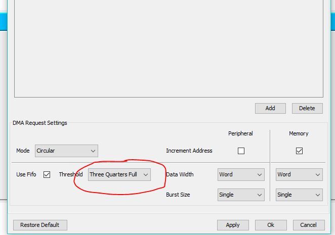

Hello!
I can reproduce your error..
To solve it put 3/ threshold fifo at both dma channels (or less, depending your config).
Handle DMA overruns by implement HAL_ADC_ErrorCallback.

Hello!
* @brief Error ADC callback. * @note In case of error due to overrun when using ADC with DMA transfer * (HAL ADC handle paramater ''ErrorCode'' to state ''HAL_ADC_ERROR_OVR''): * - Reinitialize the DMA using function ''HAL_ADC_Stop_DMA()''. * - If needed, restart a new ADC conversion using function * ''HAL_ADC_Start_DMA()'' * (this function is also clearing overrun flag) * @param hadc: pointer to a ADC_HandleTypeDef structure that contains * the configuration information for the specified ADC. * @retval None */__weak void HAL_ADC_ErrorCallback(ADC_HandleTypeDef *hadc)2017-07-30 8:33 AM
Thanks. That did the trick.
