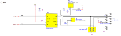

Example of schematics from STM32446E-EVAL board:
