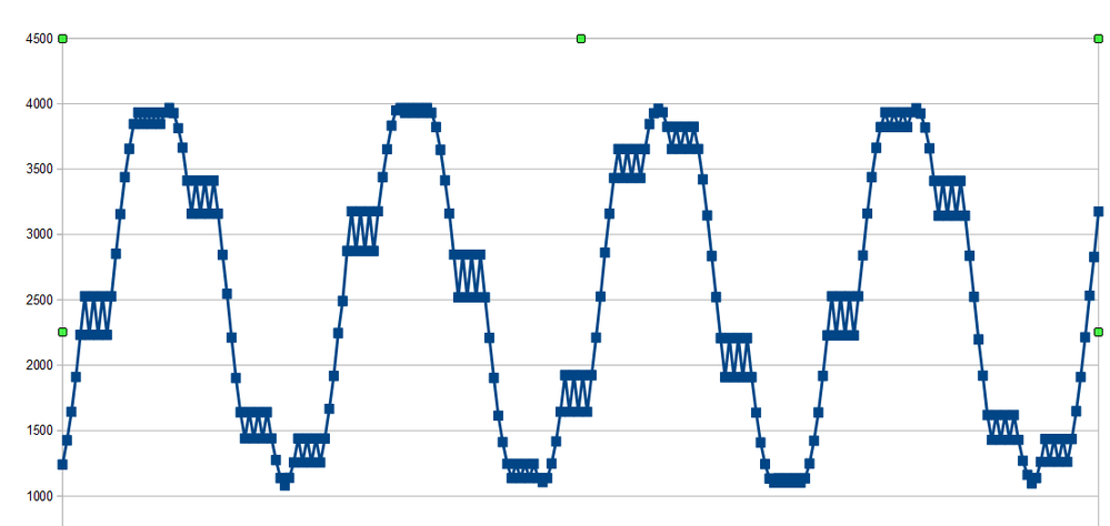

I am trying to let my STM32F429 Disco Board sample in triple mode interleaved. I mainly copied the code from ST, with small changes, and it also works. But the word-array I want the DMA to transfer the data to, has some bugs. every element of the word-array aADCTripleConvertedValue[] keeps two ADC results. The lower half word gets the first result, whereas the upper half word gets the second result: [0]=[ADC2, ADC1] [1]=[ADC1, ADC3] [2]=[ADC3, ADC2] this works fine for the first 6 results. But then I get this: [3]=[2]=[ADC3, ADC2] [4]=[2]=[ADC3, ADC2] [5]=[2]=[ADC3, ADC2] and after that, I get the new results: [6]=[ADC2, ADC1] [7]=[ADC1, ADC3] [8]=[ADC3, ADC2] and again: [9]=[10]=[11]=[8] if you look at the image, you see that there is no data missing, but it looks as if the DMA copies old values, until it gets the new one. If I delete the copied Data, the 300kHz sine looks fine. Does anybody know whats wrong here? code:/**

For continuous mode, you may be overlapping samples. Try increasing the two sample delay.
Cheers, Hal2014-07-06 5:17 AM
thank you for your reply. Sorry for the late reaction, I tought I activated the notification. I will try to extend the cycle. I also recognized that the first 3 arrays are zero, and from aray 3-5 I get good values. I will reply tomorrow2015-11-13 9:39 AM
