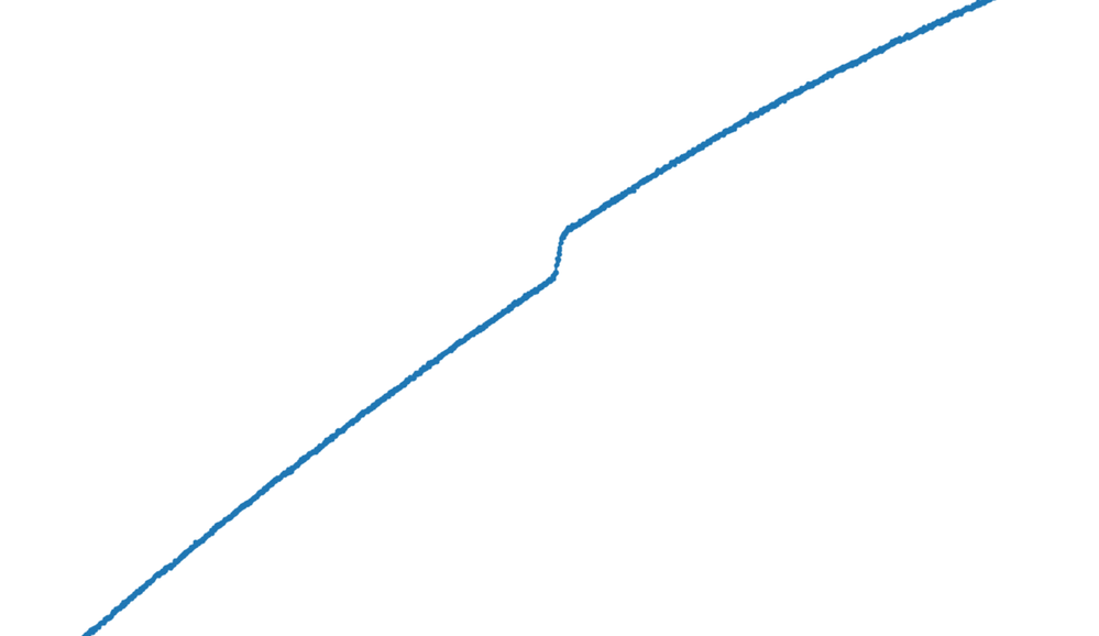

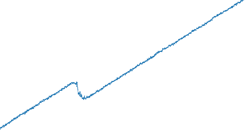

Here is thre problem curve output from ADC, the range between this two ramping point got a negative offset from original curve:
ramping points detail:

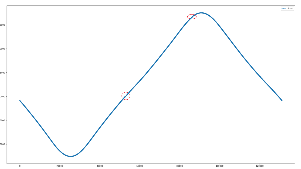

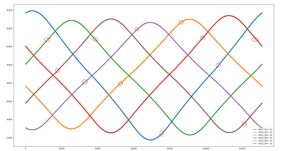

The output from six channels from dual ADC show that the problem presented randomly.

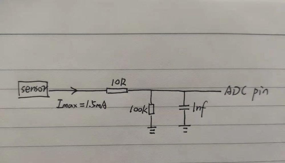

Is VDDA/VREF+ stable with sufficient capacitance on the line?
How far away are the sensors and does the behavior change if you alter how the wires between them run?
If you measure a constant voltage which is generated close to the chip (e.g. 1.5V), is the problem present there as well?
