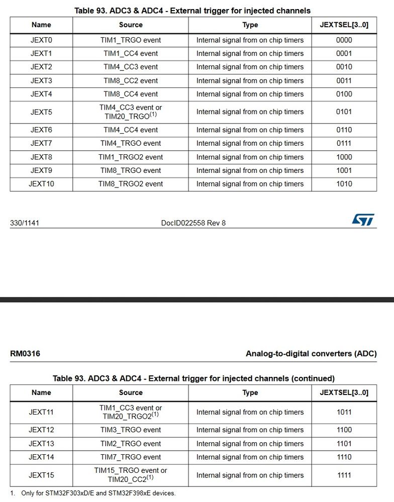

Is there a good resource for understanding various ADC modes in F303 family? There is much confusion about the terminology (regular versus injected, continuous versus discontinuous, etc.) The material presented in manual/datasheet are diffuse, vaguely or not at all defined, or, at times, inconsistent. The also seem to be inconsistent with CubeMx settings. For example, I gather from the documents that injected mode is used when conversion is trigered by software or by some event (such as timer trigger out event). However, the setting for CubeMx allows TRGO only for the regular mode and not for the injected mode.

The REFERENCE MANUAL clearly defines triggering sources including TRGO and EXTI for the ADCs Injected operation.
