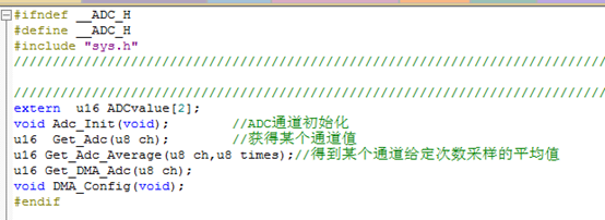

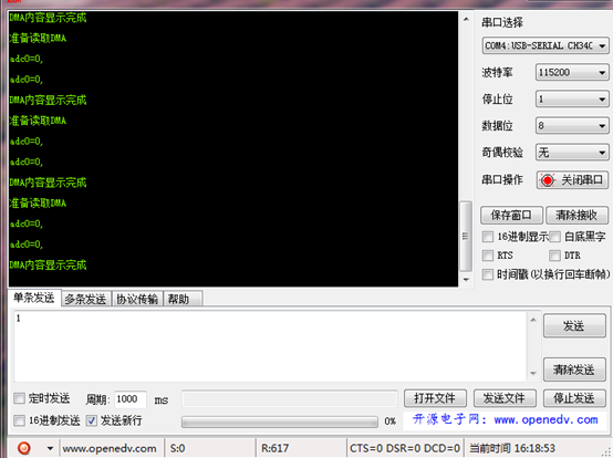

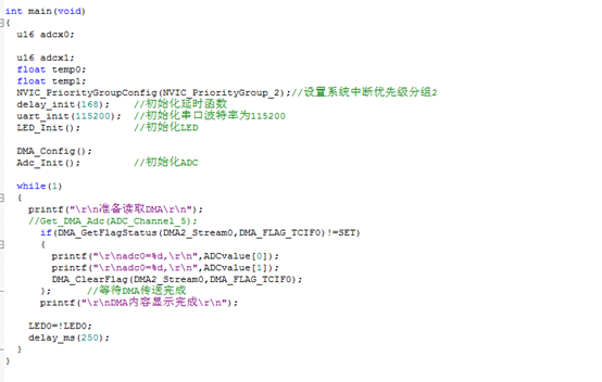

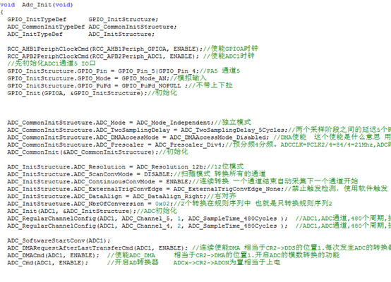

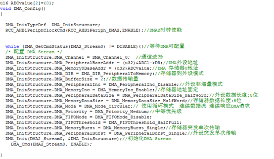

Multi-channel adc acquisition results through DMA all 0?Here is my code and phenomenon?Where is the error?Looking forward to your reply?
