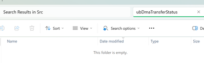

HAL_ADC_Start isn't called anywhere within the files you attached. Not in main(), not in the default task, not in any of the interrupt handlers in *_it.c.
Likewise, I don't see ubDmaTransferStatus appearing anywhere in a text file search of the files.
Sure you attached the relevant files? Am I missing it?
