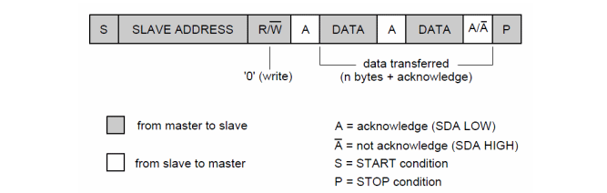

Thanks all for reply, I'm trying to send a single byte but when I set the START bit on CR2, the STOPF and NACK flag will comes active.. I don't have any device on the bus..

I would expect that. If you don't have any device on the bus you won't get the ACK after the START bit, address and R/W bit. That's why the NACK flag is set. You have to use another device with I2C to debug the communication. Also without a logic analyzer with I2C protocol or at least oscilloscope it may be quite challenging.
