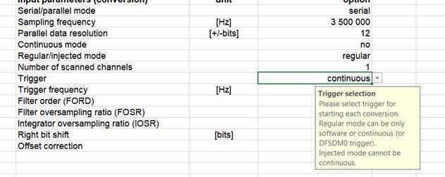

In the "DFSDM configurator" sheet, what the "Sampling frequency" on B6 cell means?
I am setting the clock frequency (2~3.25MHz for MEMS mic) and results similar sampling rate with actual data plot.
I'd like to make sure I understand the parameter correctly.

The “sampling frequency�? means the input serial clock – rate at which is the serial data provided from the sigma-delta modulator.
Each parameter has in XLS some hint – to show explanation. For example:

You should make sure to select right Trigger slection.
Which mode are you using (Serial/parallel mode) ?
Please share your paramater setting for check your use case.
Imen

I am using Serial mode, and Trigger selection is continuous, 64000 Hz.
