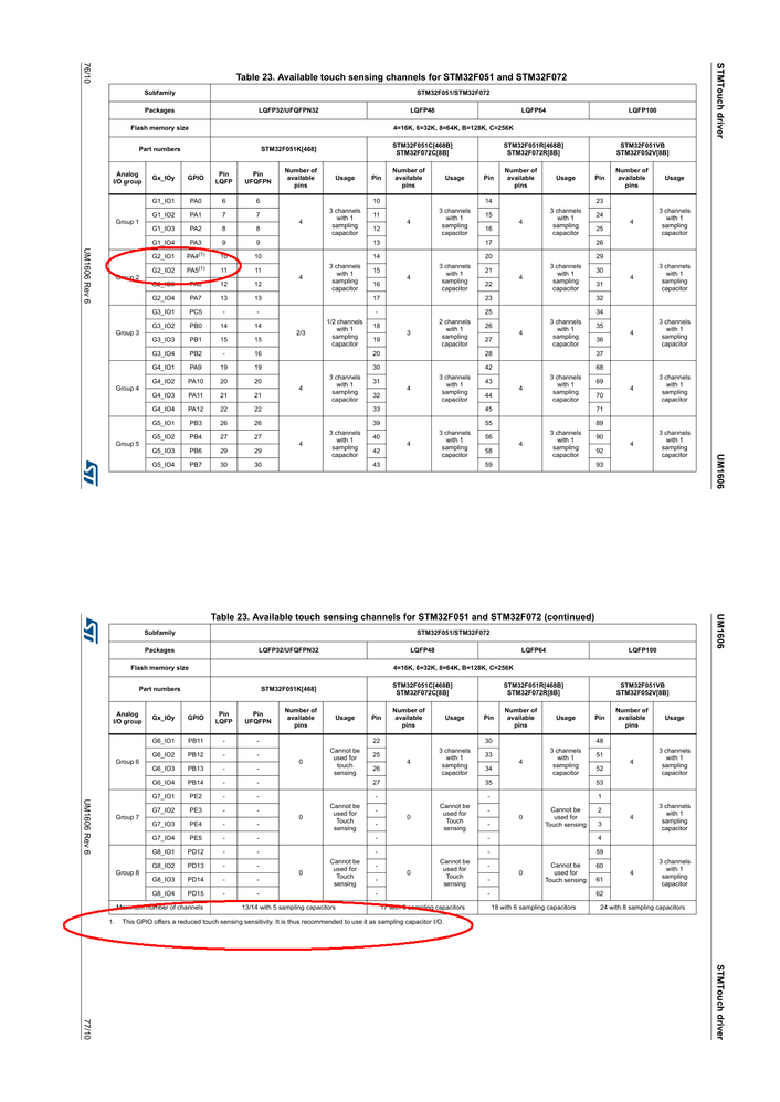

waclawek.jan
Super User
This information is present in some of the relevant datasheets, e.g. for the 'L0; but absent from 'F0 DS (as footnote to  Capacitive sensing GPIOs available on XXXX devices table).
@Imen DAHMEN​ , can you please initiate an improvement for the relevant 'F0 DS?

waclawek.jan
Super User
Which pin is it? What is connected to it internally? From which VDD is this pin supplied? What else do you have connected to this chip and what does the code do? Try to search for this particular pin in errata, DS, RM, this site.

That's it.
I have it connected to PA4 (G2_IO1). And the description of reduced sensitivity is exactly what I see. But I do not see a reduced sensitivity on PA5 (G2_IO2).
As you mentioned to Imen, there is no mention of it in the DS, RM or Errata. But I had not read the UM...
So, I have to change the PCB.
Thanks !
Wilko
waclawek.jan
Super User
No wonder, it's a "library-related" UM - why would anybody who wouldn't want to use "library" read it?
Besides DS, this ought to go to the basic touch AN, presumably AN5105. But that one, instead of giving clean examples or pointers to such, just pursues the idiotic CubeMX clicking method...
It does not even contain links/pointers to https://www.st.com/content/st_com/en/products/embedded-software/mcu-mpu-embedded-software/stm32-embedded-software/stm32-standard-peripheral-library-expansion/32f0-touch-lib.html#resource and the related UM1606.
@Vincent Onde​ , see any room for improvement (besides getting rid of the "modern feel and look")?
Now, that Application Note (AN5105) I had read. And AN4299, AN4310, AN4312 and AN4316. Reading UM1606 now =)
BTW. AN4299 does mention that not all sensors will have the same sensitivity but I didn't think that they meant the port, but the combination of the pads, shielding, groundplane, enclosure, etc.
