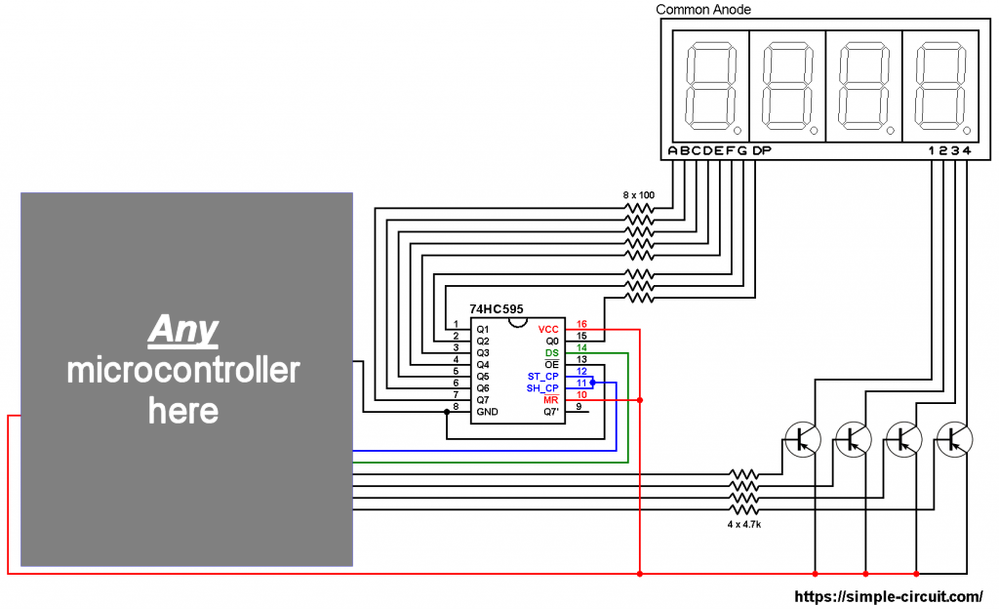

How would this differ from driving a 4-digit 7-segment display from any other microcontroller?
"I am using SPI between uC & 74HC595"
Show a schematic - how is it all wired together?
"My data is display properly but unable to handle display switching"
What, exactly, do you mean by that?
What have you tried? Where are you stuck?
Again, the concept is independent of what microcontroller you use - so there are plenty of examples to look at online ...
https://www.google.com/search?q=74hc595+7+segment+4+digit
From the first hit:
https://simple-circuit.com/arduino-7-segment-74hc595-shift-register/
