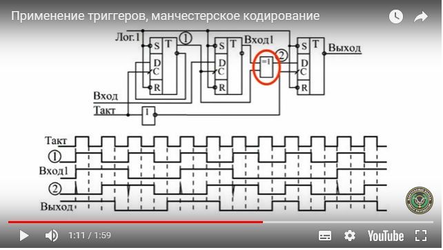

Coding Manchester from spi is possible in the native version. This requires an external clock signal, spi in master mode. The output of the frequency you need can be performed in a dozen ways, the easiest - through the timer. The frequency should be 4 times higher than the symbol rate, intermediate reports are needed to encode the exact intervals. An element in the red circle is exclusive or, for example, CD74AC86M. Counters CD4013E, or analogue in the case you need. To bypass errors you will have to use the modeling environment, or the breadboard (much longer). When encoding to the Manchester, there are no stops when there is no data - zeros are transmitted.Manchester decoding is much easier.
