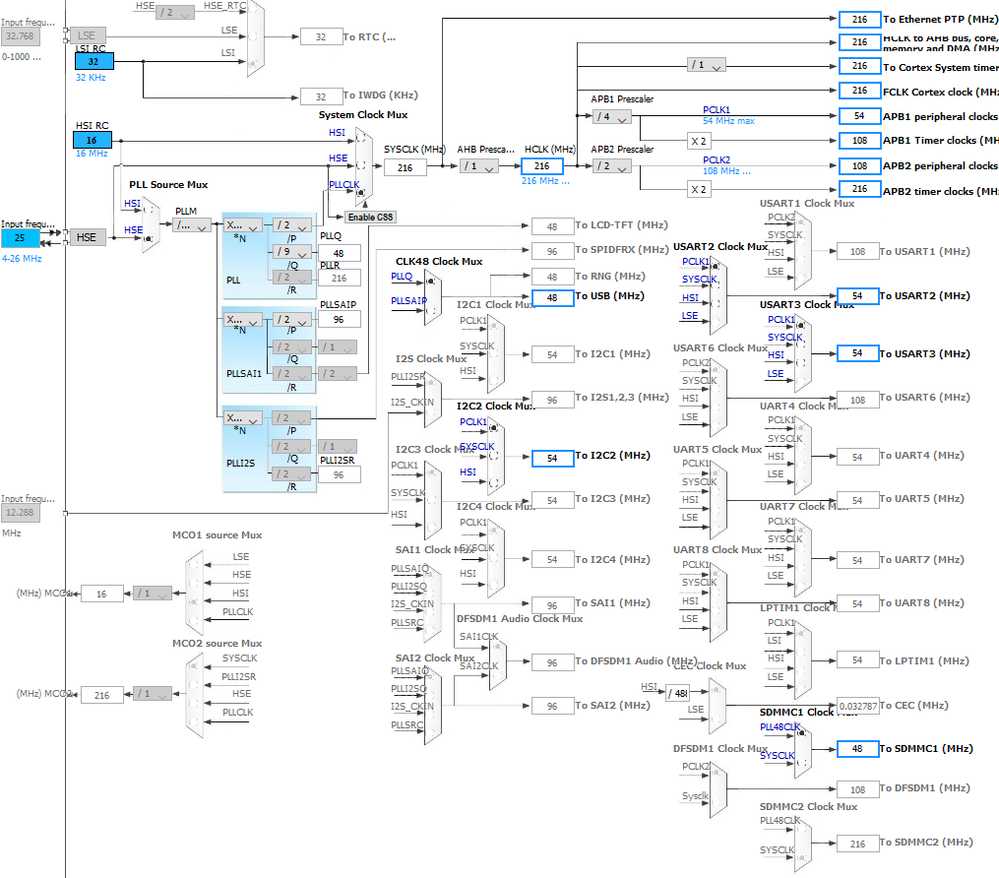

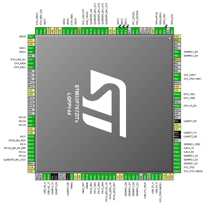

Provide pin usage on your board for the SDMMC interface, a USART usable for debug/diagnostic output and HSE clock source details, and I'll make a benchmark/integrity demo. sourcer32@gmail.com
2018-08-07 10:50 AM
Hi Clive,
thank you very much!
These are the pin connections (I hope this is what you mean):
STM32F767ZITx
PC8 SDMMC1_D0
PC9 SDMMC1_D1
PC10 SDMMC1_D2
PC11 SDMMC1_D3
PB8 SDMMC1_D4
PB9 SDMMC1_D5
PC6 SDMMC1_D6
PC7 SDMMC1_D7
PD2 SDMMC1_CMD

}PLL48CLK (48MHz) to MMC
void SystemClock_Config(void)
RCC_OscInitTypeDef RCC_OscInitStruct;
RCC_ClkInitTypeDef RCC_ClkInitStruct;
RCC_PeriphCLKInitTypeDef PeriphClkInitStruct;
/**Configure the main internal regulator output voltage
__HAL_RCC_PWR_CLK_ENABLE();
__HAL_PWR_VOLTAGESCALING_CONFIG(PWR_REGULATOR_VOLTAGE_SCALE1);
/**Initializes the CPU, AHB and APB busses clocks
RCC_OscInitStruct.PLL.PLLM = 25;
RCC_OscInitStruct.PLL.PLLN = 432;
RCC_OscInitStruct.PLL.PLLP = RCC_PLLP_DIV2;
RCC_OscInitStruct.PLL.PLLQ = 9;
_Error_Handler(__FILE__, __LINE__);
/**Activate the Over-Drive mode
if (HAL_PWREx_EnableOverDrive() != HAL_OK)
RCC_ClkInitStruct.APB1CLKDivider = RCC_HCLK_DIV4;
RCC_ClkInitStruct.APB2CLKDivider = RCC_HCLK_DIV2;
if (HAL_RCC_ClockConfig(&RCC_ClkInitStruct, FLASH_LATENCY_7) != HAL_OK)
PeriphClkInitStruct.PeriphClockSelection = RCC_PERIPHCLK_USART2|RCC_PERIPHCLK_USART3
|RCC_PERIPHCLK_I2C2|RCC_PERIPHCLK_SDMMC1
|RCC_PERIPHCLK_CLK48;
PeriphClkInitStruct.Usart2ClockSelection = RCC_USART2CLKSOURCE_PCLK1;
PeriphClkInitStruct.Usart3ClockSelection = RCC_USART3CLKSOURCE_PCLK1;
PeriphClkInitStruct.I2c2ClockSelection = RCC_I2C2CLKSOURCE_PCLK1;
PeriphClkInitStruct.Clk48ClockSelection = RCC_CLK48SOURCE_PLL;
PeriphClkInitStruct.Sdmmc1ClockSelection = RCC_SDMMC1CLKSOURCE_CLK48;
if (HAL_RCCEx_PeriphCLKConfig(&PeriphClkInitStruct) != HAL_OK)
/**Configure the Systick interrupt time
HAL_SYSTICK_Config(HAL_RCC_GetHCLKFreq()/1000);
HAL_SYSTICK_CLKSourceConfig(SYSTICK_CLKSOURCE_HCLK);
/* SysTick_IRQn interrupt configuration */
HAL_NVIC_SetPriority(SysTick_IRQn, 0, 0);
}Kind regards,
Jack.
2018-08-07 10:57 AM
USART2 on PA2/PA3?
2018-08-07 11:22 AM
Hi Clive, USART 2 is on PD5 (TX) and PD6 (RX). Thanks, Jack.
