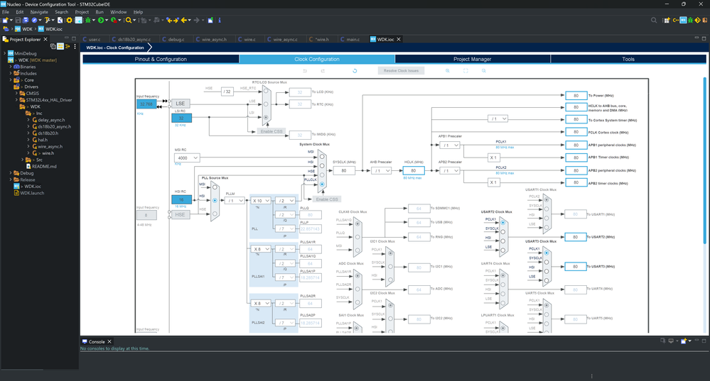

Now: I calculated EXACT baud rate for specific time slots as: br = 10M / ts[μs]. So, for 480μs reset pulse its 10416 (TX 0xf0), for 70μs it's 142857 (TX 0xff). Now when I check the times on oscilloscope they are perfectly as expected, below my scope reading resolution. So the clocks seem perfect, also no observable lag from my code. For now I don't need it, but when I add some more peripherals and a real time GUI, I need to be sure nothing will introduce any unnecessary lags. I test my setup on Nucleo board because it's quicker and safer. Also, L4 is a bit slower than my target H7, which is a good thing here.
Digging deeper, MAXIM advertises the 1-wire protocol has great elasticity with the timing, being resilient to lags. However - when I target lower times, I give even more lag resilience to the system, since it's more probable that even in case of lags the timing will still fall within acceptable limits.
I'm not sure why the 10 value works in my formula. Like I had 10 bits instead of 9. It's 8N1 - yet sending 0xf0 gives exactly 50% of the calculated time slot for the baud rate.
