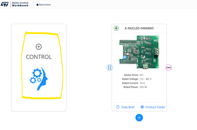

I was trying to use Motor Control Workbench, but I do not see H533RE in the control section?
Also is that possible to add BLDC motor?
Hello @Suthan,
As mentioned in the Release Note document available through Workbench tool > About > Documentations > Release Notes, the STM32H5 MCUs supported by MCSDK Workbench are:
  • STM32H5xx Family: STM32H503x, STM32H562x, STM32H563x, STM32H573x
If you agree with the answer, please accept it by clicking on 'Accept as solution'.
Best regards.
