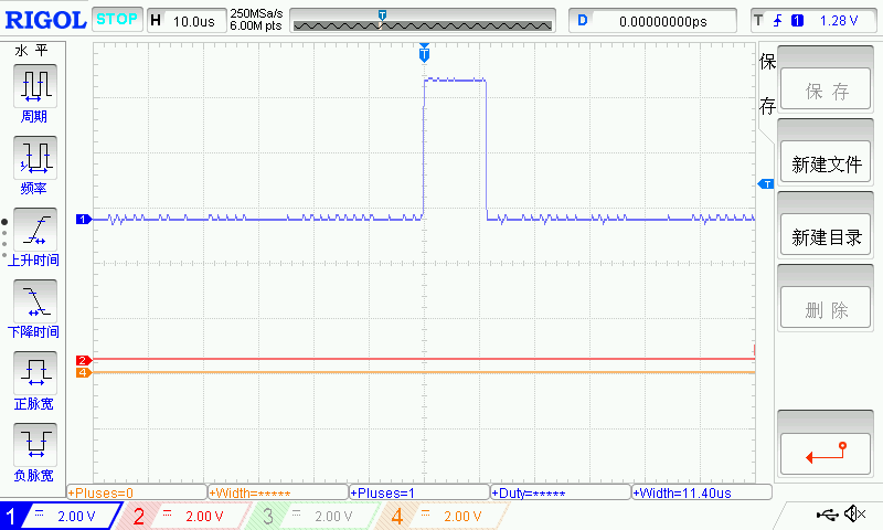

I use to stm32f302 to measure the external encoder signal. There is no problem at low speed, but it will not work when the pulse width is reduced to about 11us. I want to know what is the limit pulse width (minimum) when TIM is set to encoder mode.
Pulse width as shown:

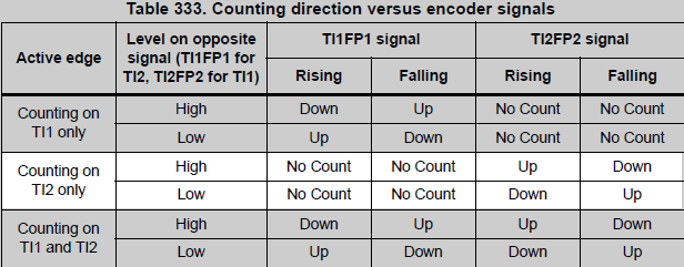

So here is an improved version thanks to the comments by @Community member
It counts the edges on TIM4_CH2, counting direction is determined by CH1 XOR CH3. Connect the direction signal to either CH1 or CH3, and pull down the other pin to GND. Leaving the unused timer input unconfigured, i.e. no pin assigned should work too, but this is not officially documented.
TIM4->CR2 = TIM_CR2_TI1S; // TIMx_CH1, CH2 and CH3 pins are connected to the TI1 input (XOR combination)
TIM4->SMCR = TIM_SMCR_SMS_1; // 0b0010: Encoder mode 2 - Counter counts up/down on TI2FP2 edge depending on TI1FP1 level.
TIM4->CCMR1 =
(0b01 << TIM_CCMR1_CC1S_Pos) | // 0b01: CC1 channel is configured as input, IC1 is mapped on TI1
(0b0010 << TIM_CCMR1_IC1F_Pos) | // 0b0010: fSAMPLING=***_INT, N=4
(0b01 << TIM_CCMR1_CC2S_Pos) | // 0b01: CC2 channel is configured as input, IC2 is mapped on TI2
(0b0011 << TIM_CCMR1_IC2F_Pos) | // 0b0011: fSAMPLING=***_INT, N=8
0;
TIM4->CR1 = TIM_CR1_CEN; // enable counterThe timer is in encoder mode 2, counting the edges on TI2FP2, and using TI1FP1 (which is actually CH1^CH2^CH3) as the direction signal. Channels 1 and 2 are configured as inputs connected to TI1FP1 and TI2FP2 respectively. Look up the General-purpose timer block diagram in the reference manual if this makes little sense to you so far. There is a 4 cycles digital filter on TI1, and 8 cycles on TI2 to ensure that a transition on CH2 reaches TI1FP1 first.
Let's suppose all inputs are initially low, then there is a rising edge on CH2. The input filter duration on TI1 is shorter, so the "opposite signal" is rising first, followed by TI2FP2 rising, resulting in the counter going up. Then there is a falling edge on CH2, "opposite signal" is already low when TI2FP2 is falling, causing the counter going up again. When CH1^CH3 is high, TI1 is the opposite of CH2, so the counter counts down on both the rising and the falling edge of CH2.

Timers in the new 'G4 family can decode DIR/STEP, they call it Clock plus direction encoder mode , see RM0440.

Looks like the encoder mode and the TI1^TI2^TI3 XOR feature (TIM_CR2_TI1S) can be abused to produce a dir/step encoder. It counts on CH2 pulses, CH1 XOR CH3 determines the direction, connect one of them to the actual direction signal, and pull the other one low.
TIM4->SMCR = TIM_SMCR_SMS_0;
TIM4->CCMR1 =
TIM_CCMR1_CC1S_0 |
TIM_CCMR1_IC1F_0 |
TIM_CCMR1_IC1F_1 |
TIM_CCMR1_CC2S_0 |
TIM_CCMR1_IC2F_0 |
TIM_CCMR1_IC2F_1;
TIM4->CR1 = TIM_CR1_CEN;The timer is in encoder mode 1, actually counting the edges on TI1, and using TI2 as the direction signal. When CH1^CH3 is low and CH2 is rising, TI2 becomes high so the direction is downcounting on rising edge, the rising edge on TI1 decreases the counter by one. When CH2 is falling, TI2 becomes low so the direction is downcounting on falling edge, the falling edge on TI1 decreases the counter again. When CH1^CH3 is high, TI1 is the opposite of CH2, so the counter goes up on both edges.
It probably depends on some undocumented aspect of the hardware design, maybe the XOR logic delaying the edge on TI1. It doesn't work in encoder mode 2. It is also completely unreliable without some filtering on the timer input (IC1F and IC2F bits).
I have no STM32F3, so I have tested it on a STM32H743 which happened to sit on my desk, so it might work with your MCU, but there is no guarantee.

Interesting idea, but I'd expect the filters been set to two distinct values, to produce a defined phase shift...
Doesn't the direction change alone produce false counts in this scheme?
