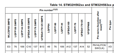

its not a curious pheonmeon .
YOU didnt configure SWD - but the chip has a default on power up , setting some pins to a default mode.
So SWD enabled at start...
see ds, pin default settings !
like this: (note...function after reset ! )

Thank you for your response, it solved my confusion. I really appreciate it.
