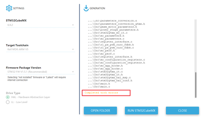

The board was designed according to the official schematic, and only 2 sampling resistors were used for ADC acquisition; When generating the algorithm, I wanted to change it to single resistance sampling, and then an error occurred。

Hello @浚钱.1 ,
Your error is probably not a real one but is due to a too restrictive parsing of the cubeMX output.
Could you please copy/paste the complete log, I guess the root cause appears above. Could you confirm that you are able to load and compile your project with Keil ?

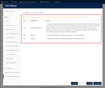

The warnings shown in your first screen-shot are there to inform you that there are hardware modification to do to enable this configuration ( Just in case you forgot to read the documentation of your board )

2024-01-15 7:21 PM
I'm sorry, I didn't know what went wrong yesterday and reported an error. It's better today and there was no error.
The top text is the JSON file of the board that was customized yesterday. I tried again today and the alarm is still there, but there was no problem generating the code.
