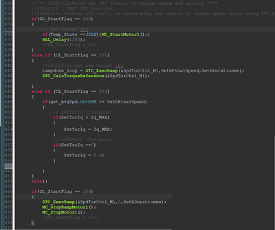

However, the issue is that when I use MC_ProgramSpeedRampMotor1(SethFinalSpeed/6, 1000) in the while loop to control the target speed, it works correctly.My main goal is to implement Speed+Torque control. I saw content related to Speed & Torque Control in the documentation, so I was wondering if I need to use STC-related commands to achieve this.
Please kindly show me where I made a mistake.

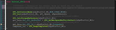

Attached are my STC initialization and control logic inside the while loop.

I'm not trying to choose between speed mode and torque mode, but rather implement a dual-loop control with both speed and torque.
In practice, should these two APIs be called in conjunction with each other? My understanding is that the speed loop will provide the Iq and Id values for the torque control calculations. Is my understanding incorrect?
