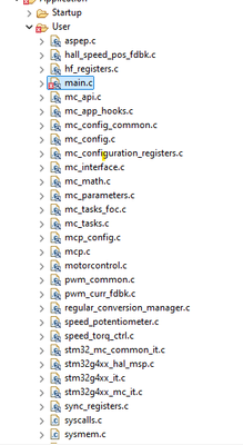

2025-06-19 9:51 AM
@Karl Yamashita do you know where can I find this function? In the main.c or in which archive?
(This photo is from a computer that can not debug the code, just to see it).
2025-06-19 9:54 AM
No i don't know where that function is in what file. You can place your cursor on the function and press F3, which will jump to that function.
2025-06-19 9:58 AM
@Karl Yamashita but if i do not find the function I can not put my cursor on the function and press F3. I am sorry, I do not know if I am understanding it incorrectly.
2025-06-19 10:06 AM
You've posted this code, so you do have the function MC_ProgramSpeedRampMotor1 to place the cursor on
