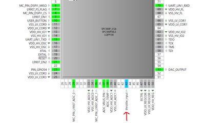

Last small doubt, In STM Cube IDE after selecting Pin usage in .ioc file, all configurations automatically get generated but in this SPC5 with these controller and power eval board, it's not getting generated.
Here, I am making Pin No. 43 as Analog Input through ADC Channel2. Can you please help me in how to sense voltage input from this pin?
