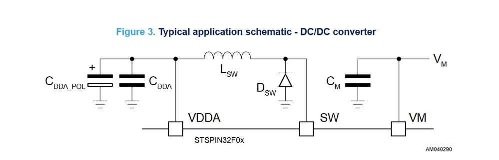

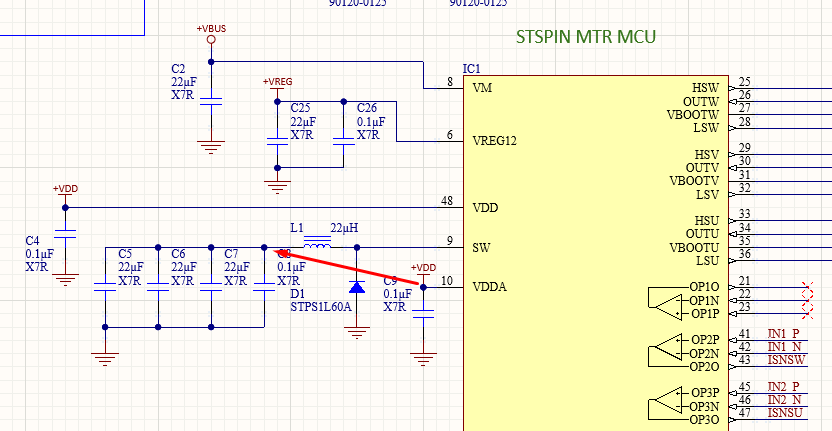

I have developed a custom BLDC Motor Controller board using STSPIN32F0. During the testing of board, it was observed that its built-in DC/DC Buck Converter was not producing 3V3. After going through AN5128, I found a mistake that other side of SW's inductor was not connected to VDDA (this VDDA is also connected with VDD). So, I shorted these two points as shown in below figure during the board was powered on. I tiny spark was on the capacitor where I placed a jumper wire but it was found that VDD and GND have been permanently shorted. I removed all the VDD to GND caps to clear the fault which was eventually cleared on removing the STSPIN32F0.

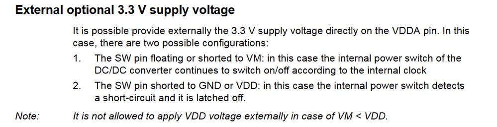

For the moment and testing purpose on the spare STSPIN32F0, can I leave this as it is and supply VDD externally? Leave this SW floating and connect VDD/VDDA externally as given below in the datasheet?

I have replaced the STSPIN32F0 but it is not connecting with the STM Programmer. May be that impulse has damaged PCB as well. When supply power (12V), initially, current is stable around zero then after few seconds starts shooting. May be there are other caps damaged as well.I will look into it or may replace PCB.

If you want use external 3.3V, you have to disconnect SW node, the SW still keep on/off.
You said after few seconds, maybe you keep SW node with external 3.3V, it will damage inside logic.
2024-10-18 1:05 AM
