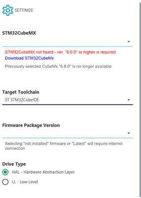

hi,
When I want to generate the code, it says that the STM32CubeMX version is not supported.
Even though I downloaded the latest version, it still gives the same problem.
How can I solve this problem?

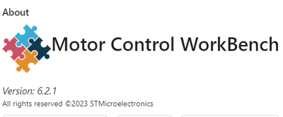

2024-01-18 5:12 AM
Hello @ENGIN TANRIKULU ,
I highly encourage you to switch to the latest MCSDK 6.2.1 version.
If you are forced to stay on a 5.4 version, the supported version of cubeMX at the release date was STM32CubeMx 6.4.0.
Regards
Cedric
2024-01-18 5:45 AM
I'm still having the same problem.

2024-01-19 4:18 AM - edited 2024-01-20 3:51 AM
Hi @CLD ,
Operating System Language: Turkish
The problem took some effort, but it turned out to be caused by the operating system language.
