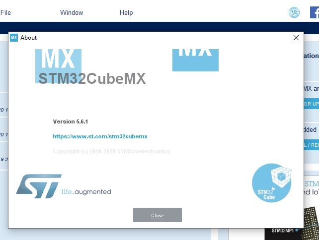

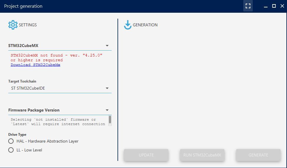

I would like to use ST Motor Control Workbench for BLDC FOC Control. I have installed version 5.4.4 and used an example project to generate code. However, the workbench doesnt generate code and gives error ("STM32CubeMX not found - ver. "4.25.0" or higher is required"). I had already STMCubeMx version 5.6.1 before installing motor control workbench and I am able to generate code using CubeMx alone. Is there a way to link these two programs manually?

I have same issue :(

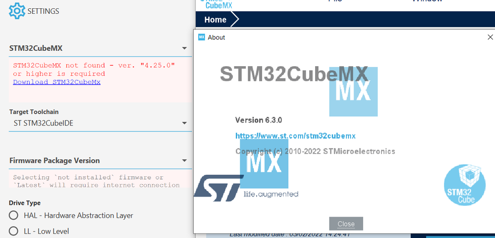

I have same issue,has it be sovled?(STMCubeMx version 6.5.0)

I used STMCWB5.4.8.
Now I have sloved the problem:my workbench can't find cubemx was because that I habitually rechanged the name of "cubemx.exe" to "cubemx6.5.0.exe"...
How can I be so follish?

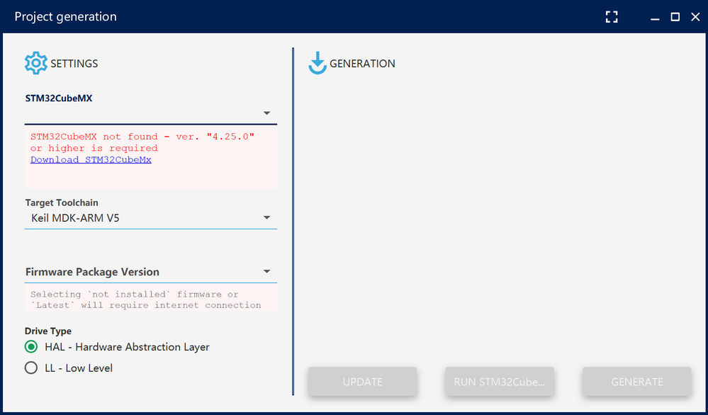

I have same problem. How can i solve this problem?
