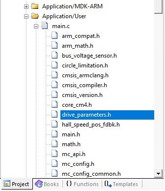

2025-04-29 11:56 PM
2025-04-30 4:16 AM
Thanks for your reply. I've been trying to adjust many of the values in that file as well as many others, but am not able to change the acceleration.

Hello @Angelo Quattrociocchi
In drive_parameters.h file, you can change the acceleration by acting on the below table with the following considerations:
- Phase 1 is the alignment step: its final speed must be 0
- At least three steps must be configured
- OBS_MINIMUM_SPEED_RPM must be less than the final speed of the last acceleration step
/****************************** START-UP PARAMETERS **********************/
/* Phase 1 */
#define PHASE1_DURATION 500 /* milliseconds */
#define PHASE1_FINAL_SPEED_UNIT (0*SPEED_UNIT/U_RPM)
#define PHASE1_VOLTAGE_RMS 4.15
/* Phase 2 */
#define PHASE2_DURATION 1000 /* milliseconds */
#define PHASE2_FINAL_SPEED_UNIT (600*SPEED_UNIT/U_RPM)
#define PHASE2_VOLTAGE_RMS 10.41
/* Phase 3 */
#define PHASE3_DURATION 500 /* milliseconds */
#define PHASE3_FINAL_SPEED_UNIT (600*SPEED_UNIT/U_RPM)
#define PHASE3_VOLTAGE_RMS 10.41
Regards
