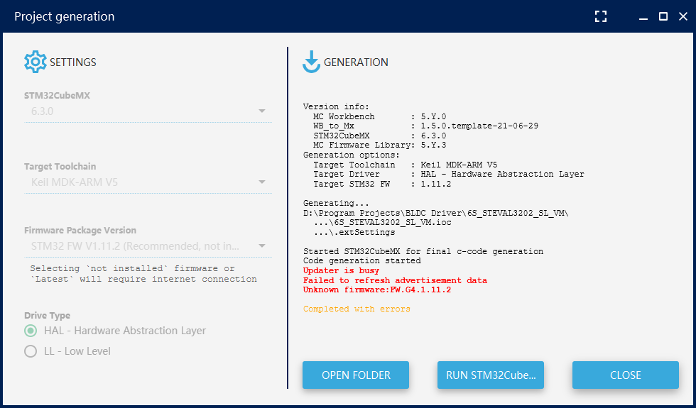

the message shows need to download FW.G4.1.11.2 firmware, but the latest firmware is 1.4.0, what's wrong with this ? any one can give some suggestion? thanks a lot.
2021-11-12 5:44 AM
Hello @�?� REN ,

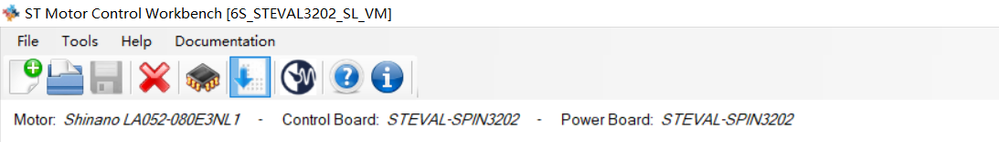

Your issue is strange, the SPIN3202 is based on a STM32F0, not on a STM32G4.
The firmware required is the stm32F0 HAL version 1.11.2
You can try to install it directly from cubeMX. or if it does not work, it is available to download here :
https://www.st.com/en/embedded-software/stm32cubef0.html
Regards
