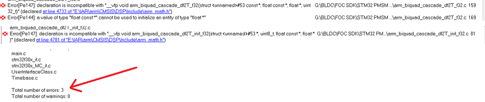

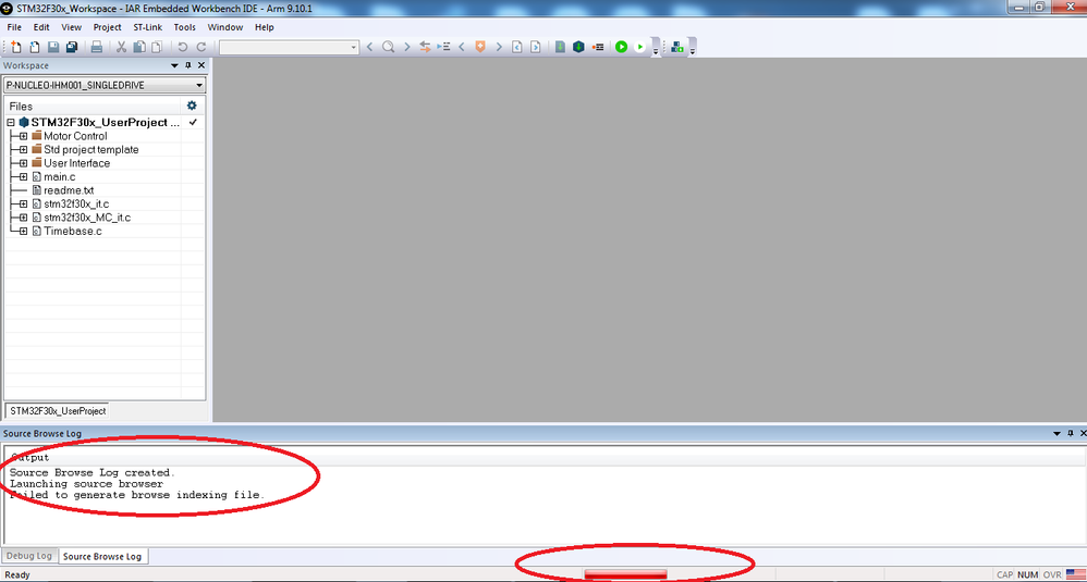

I am using ST MOTOR CONTROL WORKBENCH 4.2.0 (Legacy Tool)
but unable to compile with I.A.R 9.10.1 .
Why I have to chose tools because I want to work with STEVAL-IHM038V1 (Active)
Tools ? which is not supported mcsdk .
Please update .. Is there IAR Version issue ? or what .
Karan

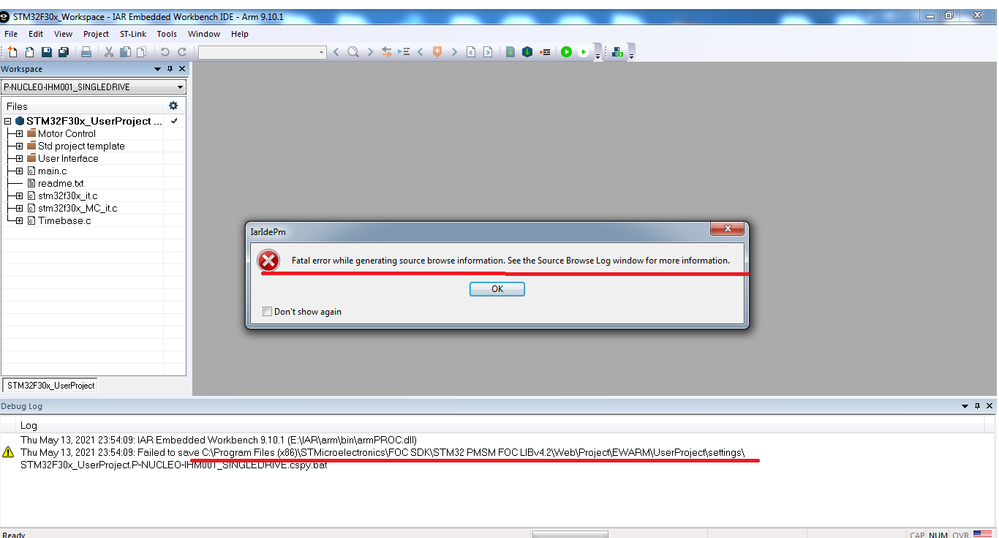

Hello Karan,
It seems that your issue does not come from IAR itself, but from the location you use to compile your code.
your Program files directory is probably write only if your are not admin of your computer.
I would advise you to move your folder source inside your user directory.
Regards
Cedric
2021-05-14 11:04 PM
Hi
@cedric H (ST Employee)
Thanks for your concern ..
As suggested , I have moved FOC SDK
-> STM32 PMSM FOC LIBv4.2
-> STM32WB
to different directory in different drive.
But Again Unable to Build Successfully.
Please advise ..
Karan
