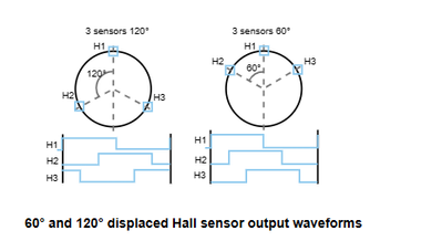

Based on your hall sensor displacement you should be getting a waveform similar to above when the motor is running.
All the 3 hall sensor signals shall not be all low or high, then there is a problem. Tap the 3 hall sensor signals and check on oscilloscope.
