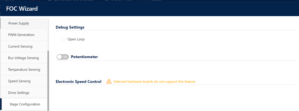

Using the MCSDK 6.1.2, you can enable the potentiometer while configuring your project via WorkBench.
Under Stage Configuration, check the Potentiometer box :
The generated project should include a speed control using the board's potentiometer.

Hello Ranjeet Singh,
