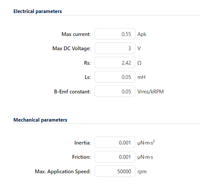

I am using IHM17m1 with nucleo F401RE to control an 3v bldc motor from maxon , facing some issues in tuning
issues

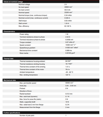

1 - the motor parameters are important for sensorless motor control , i need some parameters for motor control work bench so i calculated some values but even after putting that some variables in motor pilot (torque) is not correct .
attached the motor data sheet , i want to know that how to calculate the motor workbench parameters from this data sheet (i want to know whether my calculations are correct or not)

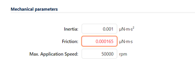

issue 2 - my rotor inertia is 0.000165 according to my calculation , but i can only enter 0.001 in motor control work bench . is that become a problem (facing some issues with proper working of my motor)

Finally, the inertia is only used for PID computations, that can be manually tuned through the MotorPilot, so having a wrong one to start with is not a severe issue.
