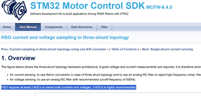

Hello @Mani2,
As you mentioned in your attached snapshot: "HSO requires at least 2 ADCs to sense both currents and voltages".
In this same HSO Overview chapter, a figure "Three-shunt topology hardware architecture" shows the needed Phases Voltage ADC topology that is not available on IHM16 HW topology. Only Current via R shunt is available.
HSO is only available on STEVAL-PTOOL4A inverter and B-G473E-ZEST1S/STEVAL-LVLP01 for the moment.
Hardware IHM16 topologies are different for 6-step IPD and FOC. Generating projects for both modes you will have a list of hardware modifications to be done.
We do not plan to adapt this IPD feature for FOC. IPD description is available "Initial Position Detection" chapter of User Manual "six-step Firmware Algorithm" part.

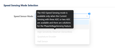

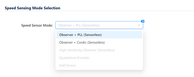

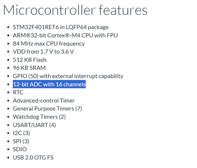

However, I’ve attached a screenshot from STM32 Motor Control Workbench, where the HSO speed sensing option is disabled for my STM32F401RE project. The tooltip mentions that HSO is only available when current sensing is done using two or three ADCs and when Phase Voltage Sensing is supported. Since STM32F401RE has only one ADC, and my setup doesn’t support Phase Voltage Sensing, HSO is not available with my hardware configuration.
Since STM32F401RE only has one ADC, and my setup doesn't support phase voltage sensing out of the box, HSO is not available with this MCU and board configuration.
That’s why I’m looking for alternative solutions.
I want to know if there is a way to prevent the backward motion using FOC only, without using HSO or switching to 6-step mode.
