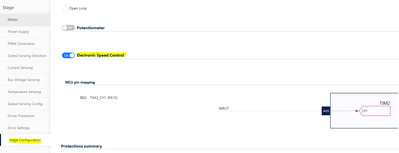

In our MCSDK, if you use the inverter B-G431B-ESC1, you can activate the PWM input control:
Doing so, the generated project will contain an esc.c file implementing this feature.
The generated IOC will allow you to understand the timer configuration we used.
