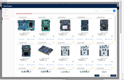

If you launch the MC Workbench, you will be able to select it and see the Control Boards compatible with it, if you choose a Nucleo, you need a Bridge card such as the X-NUCLEO-IHM09M2.
