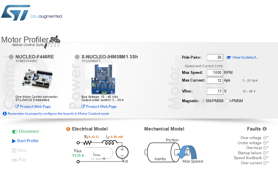

Before to write any code that can take the speed reference from the potentiometer is important that the FW is correctly configured according you boards and motor.
The procedure described above is correct. Motor profiler is optional if you already have the required motor parameter like Stator Resistance, and Inductance, BEMF constant etc
Of course if the profiler works it calculate and estimate these parameters for you.
When you provide 14V using the profiler which is the error that you get? Can you attach some screenshot?

Thanks for answering me, this is my picture.
From many years I have been working on this one with no success. Thank you.
It can depend by the implemented motor profiler firmware that is not compatible with the specific motor that you are using.
