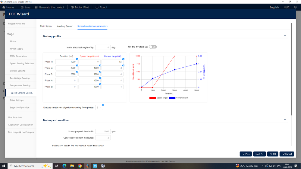

I have changed the rpm as 1000 at all phases.
And now the shoot up process has resolved.
