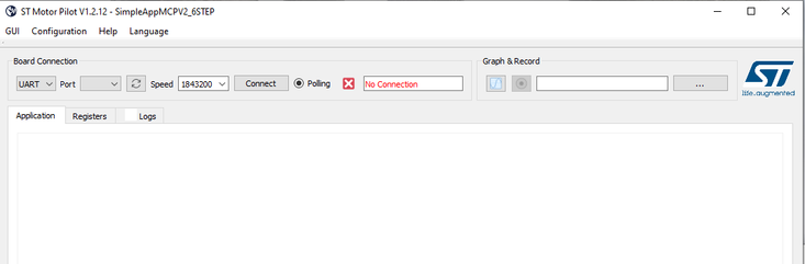

When I launch the program it looks like this:
It shows that there is ``No Connection`` to the board and the only option is for a UART on com3 or com4. When I try com3 and press Connect, the program closes.

Hello @Tedco,
You can try the "Discover Board" feature available on MC Pilot>GUI>"Reset GUI to Default".
Refer to "Getting Started with Motor Control SDK" chapter in "Workbench tool">About>Documentations>Documentation".
