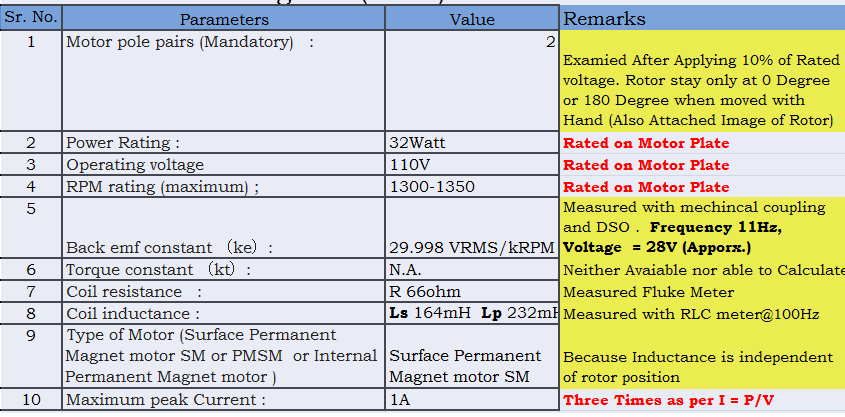

I am working on below setup:
Hardware:
Board : EVSPIN32F0601S3 board (Just received)
CPU : STSPIN32F0601
USB to USB Isolator : STLink
BLDC Motor :
Software:
ST Motor Control Workbench 5.4
IAR EW for Arm 9.10.1
STM32MXCube 5.6.0
STM32CubeIDE 1.3.0
Motor Profiler 5.4.6 (Not Supported to this board )
I have selected EVSPIN32F0601S3 in MC Workbench and will try to spin motor by only entering BLDC Motor parameters (as above)
Rest all default ..
Before to Connect the motor with Hardware . I Just want to know is in Msg #1.
Thanks for your concern ..
Karan
