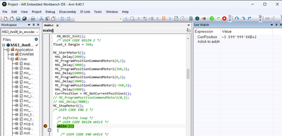

Hello! @GMA
I try your example with 200 rad. works. I change to 360 rad and it is not work. I add some logging to understand what happens between movements. I pin some screenshots.
2024-09-09 2:08 AM
Hello @ABask.1,
According to your logs, commands are correctly handled, but motor has not processed the number of rotations as expected.
