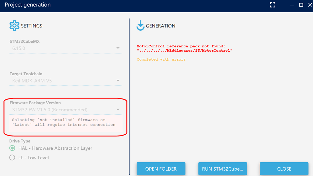

I was trying to generate a STSPING4 project with MCSDK 5.Y.4.
All the config and pin checks are successful.
However, there is an error in the attached picture; also, the full LOG is attached.
Seems some paths are incorrect, but I don't know how to fix them.
Maybe I need to install something more? Or need to copy some folder somewhere?
Thank you very much.

@Junde wrote:Maybe I need to install something more?
Yes, that does seem to be what the message is telling you:
2025-11-06 2:29 AM
Hello @Junde,
As mentioned in the release note documentation available through Workbench tool > Documentation, required STM32Cube Environment is: STM32CubeMX v6.4.0 and STM32Cube_FW_G4_V1.5.0.
Warnings might appear during project generation. If the generation concludes with the creation of the main.c file, proceed with the project.
2025-11-06 3:45 AM
Thanks for your kind reply. I already installed this version; if not, it will show like "STM32 FW V1.5.0(Recommended, not installed)"
And as @GMA information, MCSDK 5.Y.4 must work with the STM32CubeMx 6.4.0.
