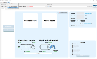

I use MCSDK 6.2 ,I want use UNCLEO-G431RB + X-NUCLEO-IHM07M1 profiler motor model ,but open “motor profiler” ,Control Board and Power Board is blank。

Thank you for your reply!I have connected the development board through uart. You can also see from the picture that the baud rate is 1843200bps.I changed to another PC and the problem did not change.

Hello @TLi.5
The new strategy is to allow you to generate your own profiler project with the workbench.
Doing so, you will be able to select the combination you want, and to tune the PWM frequency according to your motor.
To do so, please read the documentation available at the highlighted location on the screenshot below.
Regards
