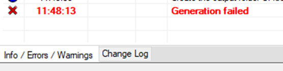

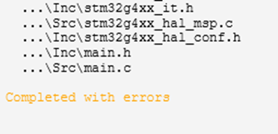

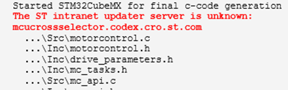

During code generation, I get the following error:
“The ST intranet updater server is unknown: mcucrosselector.codex.cro.st.com�?
and also,
“Completed with errors�?
In the main log, I get:
“Generation failed�?

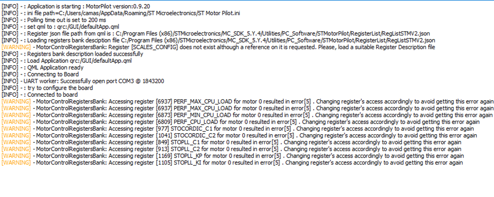

The board does connect with Motor Pilot about 50% of the times I try, but immediately I get the following errors.
Finally, from the main dashboard I get an over current fault, but if I click on Acknowledge Fault, nothing happens.

First, the issue at generation phase does not prevent you to generate a working project. The " generation failed" status is then not relevant in your case. I reported the issue you saw to our cubeMX colleagues.
The screen shot of the Pilot you attached does not show any errors but just warnings. Those warnings are not critical but it is true we need to remove them as it brings confusion. From your attachment, I see that the Pilot is actually connected. Could you attach a screen shot of the "Terminal" window when it fails to connect ?
If nothing happens, it means that your error is permanent.
If I understood correctly, you have an over current fault as soon as you connect the Pilot to the board, even before you start to spin your motor. If this assumption is correct, then you have an issue with your overcurrent protection circuit. What is your topology ? Are you using external signal connected to Timer break pin or embedded comparators ?

@cedric H Wow, thank you so much for your answer, and further questions which really led me to the solution. Knowing that I could basically ignore the error/warning messages, I felt confident to hone in the current sensor topology, and setup.
I just realized that for a long time, I was looking at the setting for an external network gain, not at the embedded over current protection topology. Once I set up the internal amplifying network gain to match my setup, which is different from the EVSPIN32G4, since my board nominal current is 5 Amps, everything worked like a charm.
