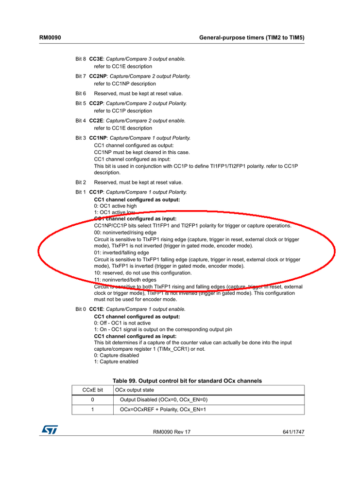

There is also an indirect mode allow for a single pin to go to two channels so for example CH1 and CH2 can capture opposite edges.
2020-04-17 11:46 PM
Look up PWM input mode in the reference manual.
2020-05-12 8:54 AM
At a time you can either capture rising edge or falling edge but there is a solution initially set the register for capture the rising edge then in interrupt change that register to capture the falling edge of the pulse . 1st store the count value when rising edge is detected and when faling edge is detected minus the current counter from previous counter. this way you can measure the frequency(pulse length).
dhruti
2020-05-12 11:02 AM
It is possible to capture the rising and falling edge of the input signal using the Timer unit, our friend who has already shared the recorder above.
