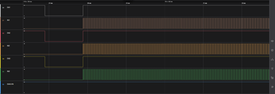

I was able to get the motor profiler application running to check if my setup is good and then,
I probed the ENx lines with a logic analyzer looks like they are normally low and then toggled once and held high once the application starts.
DIAG-EN seems to be driven identical to ENx for the most part except its not toggled always held high,
but you need to handle overcurrent and thermal protection through your circuit/code as per the datasheet.
