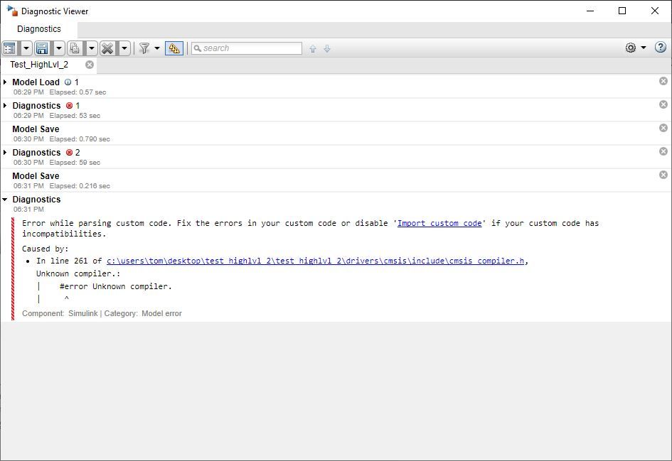

This works just fine until the error message shown in the following screenshot.

2020-06-22 10:04 AM
It certainly has something to do with the fact that Simulink does parse the code in the absence of a full project in an IDE. The first of the error messages, caused by stm32f4xx.h in line 175 was because there was no target MCU defined, which leads to an error. The latest error is caused by the same issue, but this time with the issue of the target compiler not being defined.
For the first error code needs to define the macro STM32F446xx in order to parse correctly, and in the second case the macro associated with the compiler you use.
I would personally have a look at the header file dependency in the libraries from ST, identify the highest level header, i.e. the header file that is included in all the other files, and change it to add
#define STM32F446xx /* file st32f4xx.h line 157 now parsed*/
#define __GNUC__ /* or whatever tollchain you plan to use */
That should add the required information to parse the files correctly, and if they match what the toolchain would do there would be no issues.

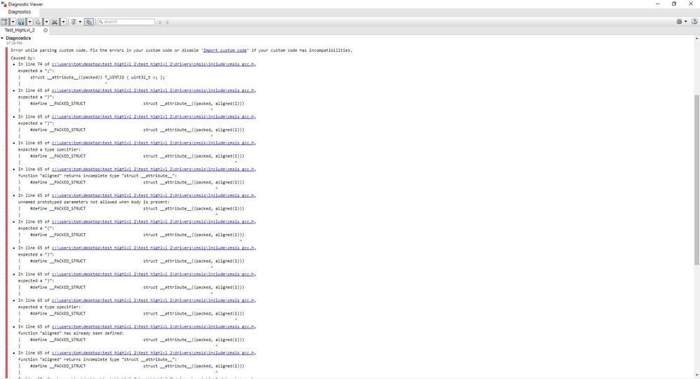

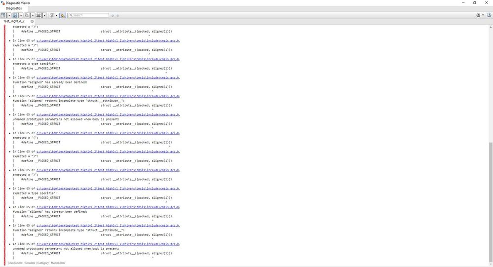

Now i'm getting this one.
(sorry i'm not familiar with c code)
Btw: I'm using SW4STM32 as my toolchain.
2020-06-22 10:48 AM
I am afraid that you may have run into C code which uses C language extensions not recognised by Simulink. It says in the begining of the second screenshot—which may actually be the first—that you have an option to disable "Import Custom Code", which may be defined precisely for this reason. Might be worth a try.

2020-10-14 9:11 AM
Dear @tired
Did you checked your .h header calls tree?
According to your error logs, I am not sure than "packed" and /or"T_INT32" are recognized where used for the first time.
