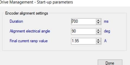

So I suppose my questions are:
1.Am I correct to assume the only thing that is needed to align the encoder to 90degrees is to set this alignment value in motor control work bench, build the project and then from the monitor click "align encoder" (shaft moves) then "start motor" and the motor should spin? Right now it just locks up.
2.Since the motor is not spinning but locked and drawing current I have tried reversing the counts (from workbench) and re-building, also tried different sequence wiring on the motor. The rotor is still locked, do you have any suggested next steps? This would be greatly appreciated. Thank you! Dan

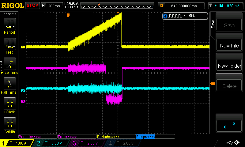

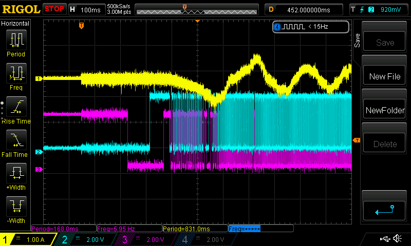

2020-05-18 2:57 AM
I tried today again and it worked.
THis may help you:
Start up waveform
align waveform
2020-05-18 4:48 AM
